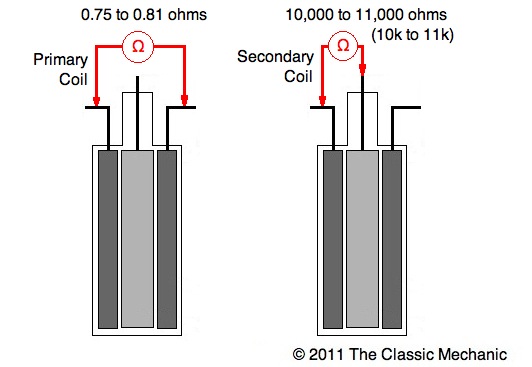

I just checked the ohms reading on the ballast resistor.  It registered right at 2 ohms.  Also, cranked the engine over with the ignition on and checked the volts at both the + and - side of the coil while cranking.  It registered about 8.5 volts while cranking on both sides.  Unplugged the magnetic pickup plug and it still just registers .5 volts, even while cranking with the ignition on.  Still haven't swapped the ECM as that's takes a little longer to unbolt from the firewall, etc. Also, unplugged coil wire from center of dizzy and grounded on engine with ignition on and cranking engine and got not spark whatsoever out of the coil wire.  Bad coil or ECM?

Thanks Bullitt.  My buddy just left.  I'll check the coil in the morning.  I do have a question though.  Is the Electronic Voltage regulator supposed to be wired into the Start/run wires coming off the ballast resistor and ECM?  I mean it's been wired this way for three years and for the most part always started and ran fine so I don't see why after three years it would suddenly make a difference.  Just thinking out loud.  My buddy and I looked at various diagrams of the ECM, ballast resistor, coil wiring and didn't see the electronic voltage regulator in any of the wiring diagrams but I must have seen it wired into the circuit three years ago when I installed it or I wouldn't have done it??? Once again, just for grins we pulled the coil wire out of the center of the dizzy, put it next to a ground and cranked the engine.  Still no spark.  I'll check the coil per Bullitt's instructions tomorrow and if it shows good I'll install the old ECM tomorrow to see if that makes a difference.   With the ignition on is both the + and - side of the coil supposed to be hot in the run position, but not cranking?   If the coils good and the spare ECM doesn't make a difference any other ideas?  Thanks again for the help and suggestions.  I hate electrical issues!!  I thought I put all this behind me when I converted to the electronic ignition.  :pullinghair:

Use multimeter on the coil positive post while cranking.   Should be around 8 or higher.  If that is good then swap out that ECU with another...it probably has gone bad.
Bullitt-
#22
Same Blue wire goes to the voltage regulator that feeds the ballast resistor so it sounds like your wired correctly.  :bigthumb:
If the coil checks good the next logical step is to swap out the ECU I suppose.
