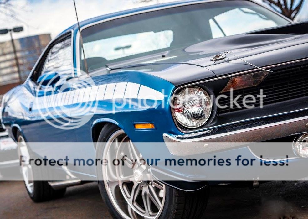

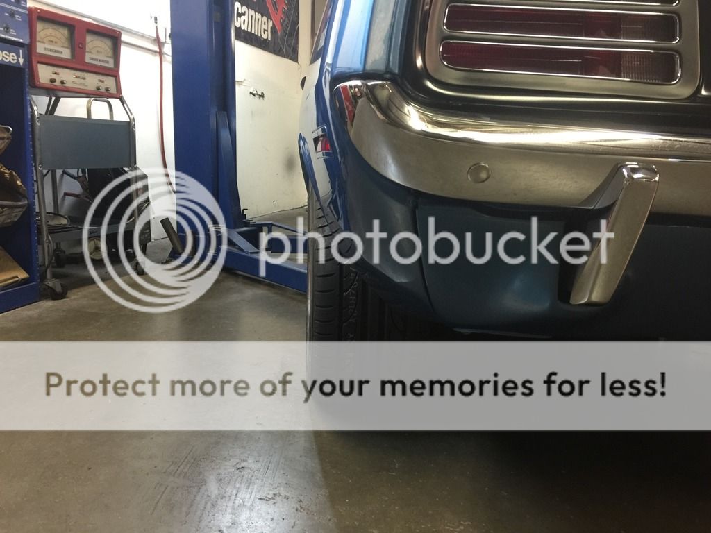

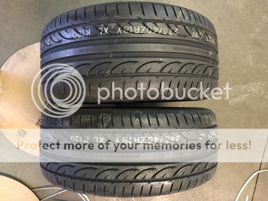

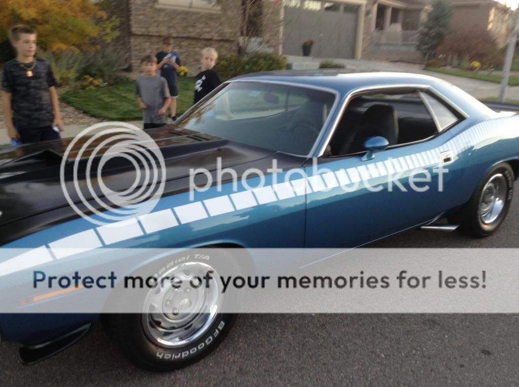

When I bought my '70 Cuda it had the 15" rallye's, which were nice but not the direction I wanted to go with this car.  I was looking for more of an updated "resto-mod" look.  I found a great deal on Hankook Ventus V12 245/45/18 and 275/40/18 with US Mag U111 Rambler textured gunmetal grey 18x8 and 18x9.5.  The stock spring location gives abut 3/4" room, fits inside the rear quarters with no rolled lips.  Fronts also fit perfect, no rolled lips, not rubbing on frame.
Rallye wheels the day I got the car
New US Mag wheels
That looks really good!  Really surprised they fit as that's some good size meats back there.
LOVE LOVE LOVE that color on an AAR and the white stripe is fantastic.
Everyone has BFGarbage & Ralleys
the 18s look & fit so much better  :t2027:
Love it Dan!   I loved my 15" minilites but you just can't get performance tires in 15" anymore.

That 3rd photo...WOW! :ohyeah:
