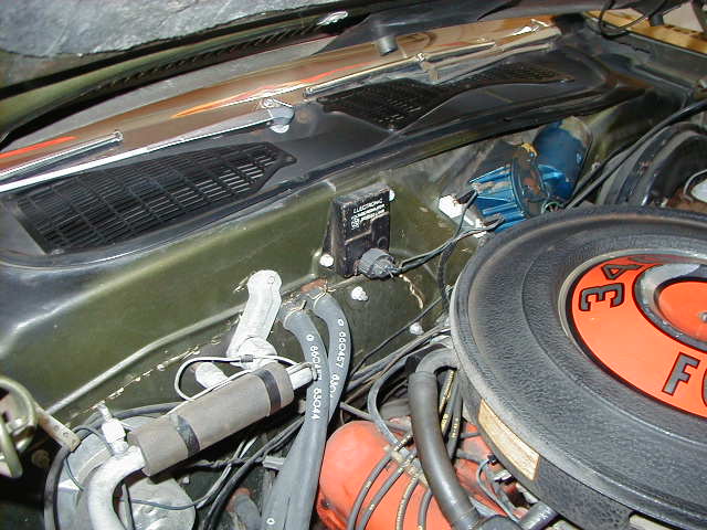

My F8 70 Cuda 340 convertible didn't have a blacked out cowl or core support...
I'm not sure the guy with the "Spray the cowl black" job always followed the tech bulletin guidance...
This picture of an F8 70 Cuda 340 Convertible is not mine but it is blacked out.
Can't say whether it's original or not but looks like how they would have done it from the factory.
