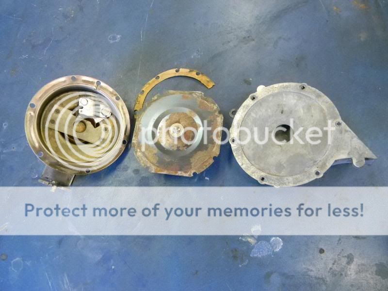

Try not to laugh but it seemed odd there were two of them. Are these both horns?
Burdar
Yes, those are your horns. There are two because one is high pitched and the other is low pitched. They should be painted gloss black.

If a horn doesn't work, you can drill out the rivets and take it apart.  Sometimes is just needs a good cleaning in there.  Once the contacts are cleaned, you can use small bolts to hold it back together.

nsmall
@Burdar
Thanks for the tip on the horns. I'm going to go and try as they don't work and I was just going to give up on the whole situation but you have peaked my interest.
