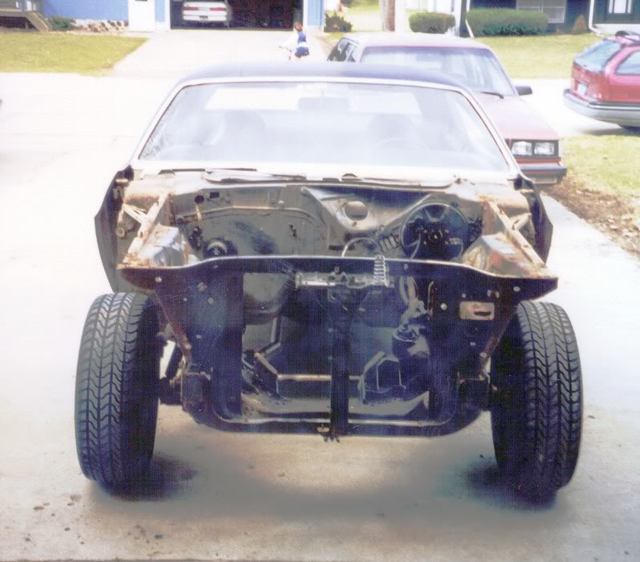

Hi guys, I'm getting ready to install US Car Tool core support and got a question.  The chassis radiator support has a gentle bow in it toward the middle, is that normal or should I flatten it to match the core support piece I plan to weld on?  Car is a '73 cuda.  The support that will be welded on is the piece in gray primer.
Burdar
I'd say flat.  That doesn't look like a gentle bow to me.  That's pretty drastic.  Here is a picture of my 73 Challenger.
b5cuda
That makes sense to me - thanks!
Burdar
If you already have the radiator you plan on using, fit that in the car first.  Make sure it will fit with the rad support straightened out.
