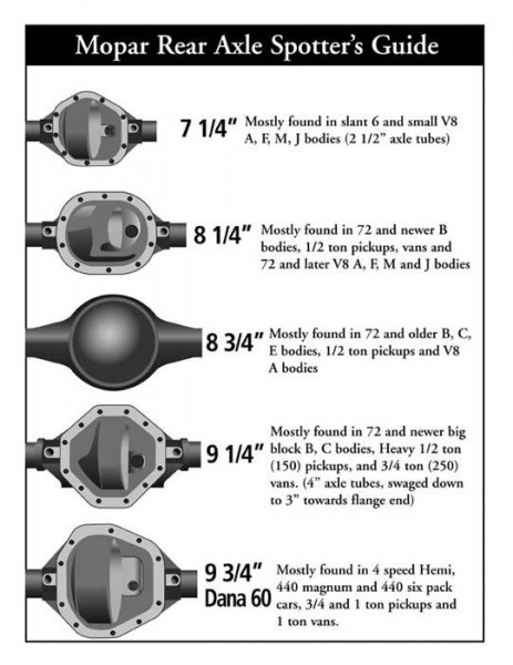

  I'm just wondering what kind of rear end that is & is it correct for a '70 B-body?  :clueless:
Looks more like the 8.25 used in later B-bodies
