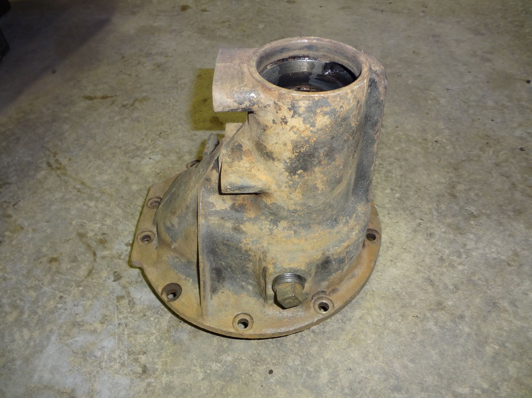

Looking for feedback on finishing a Yukon 489 case and would like to preserve the raw cast iron look. Prefer not to paint or use RPM.
I have seen several recommendations for treating  exhaust manifolds with slip plate to accomplish this.
https://streettechmag.com/2022/01/08/slip-plate/
Slip plate, powder coat or ?
Thanks

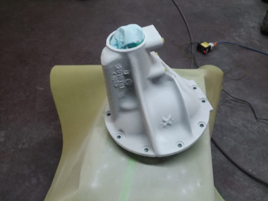

Burdar
I had my center section sand blasted and then powdercoated clear.  I'm interested to see how long it stays looking nice.

Clear powder and clear Cerakote are the other 2 on my list.
