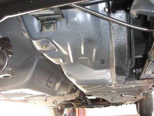

I'm no expert and I don't know how accurate this is, but there are a lot of pics here.  The car has been sold so I don't know how long this will stay up.
http://www.transamflorida.com/1970challengerTA340.htm
I believe the car belonged to Iggy Alonso ?
Scrolling fast through the pictures I only counted six "glaring" mistakes, but otherwise a nice car  :drooling:

Nicely done car for sure, but some big mistake on the details if you are using that car as a standard to show accuracy.  I'll just list a few I see...
Grill painted wrong (should have two silver ribs showing)
Pinch welds below rockers should be blacked out
Wheel wells (front) should have under coating
Mufflers should be black
Front Fenders should have studs on the back mounts and not bolts (2 or 3 is normal)
Belts on engine are wrong style
Grommet on valve cover should be painted
Dash VIN is missing screened logo
"A" arms should be cosmoline
Ink stamp numbers on trans are way off for the font
Something looks off too about the VIN stamped on the Trans.  Would have to see a better photo to say for sure.  But once I find a fake stamped VIN I pretty much start to question all the other things on the car.  If it was a re-stamped VIN on the trans, I would look at that really clean and near perfect fender tag closely too.   :alan2cents:

Don't use that as a reference resto.
Look for pictures of Troy Bray's FT6 4spd T/A that was a 30K mile so cal car BEFORE he restored it himself..
He has tons of pre resto documented pictures to replicate how that car was delivered. All marks, daubs, numbers, undercoating patterns etc, were documented, stenciled, measured, pictures and put back during resto. Steve in Massachusetts owns it now.
