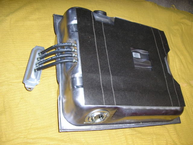

Quote from: rdf on May 07, 2019, 03:40:00 PM
Here's my new gas tank...was gonna put it in last weekend but I wanted to know what the 4 stubs are for on the back of the tank?? They connect to 4 hoses up on the body but I can't tell what it's connected to.  Any ideas??
In a stock set-up those four hoses hook up to a gas tank vent system. Your car might still have the vent canister mounted up in the rear sho :alan2cents:ck crossmember !
rdf
Quote from: anlauto on May 08, 2019, 07:16:36 AM
Yes, there is still a canister up attached to the body so I'm assuming that's what it must be.  Is it functional?  Can I (and should I) replace the canister contents?  I've never had to deal with this before, which is why I'm a little stumped.  :thinking:
If we never drown we'll never know how well it tastes...so tell me how it tastes and I'll know just how well you drowned.
Burdar

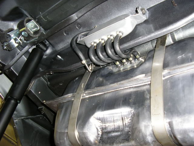

That is called a vapor separator.  It's what vents the gas tank.  The tank needs to be vented.  Don't throw it away.  There is a valve inside that lets the fuel vapors travel to the charcoal canister in the engine compartment.  If the charcoal canister is removed, the tank will still vent but the vapors will be open to the air.
Soak your vapor separator in EvapoRust to clean out the inside.  The valve(check ball) inside only allows air to pass through it in the middle of its travel.  It will block air flow when the check ball is against its seats.  You can block all but two of the nipples, then suck/blow through it.  You should hear/feel the check ball moving.
rdf
Quote from: Burdar on May 08, 2019, 08:41:16 AM
Wow, thank you for the info and the pictures....makes it much easier to piece together.  When I bought the car, it had a SB, 360 in it but it didn't have the charcoal canister in the engine compartment.  I don't plan on putting one in either so my next question would be, is it ok to connect the gas tank to the vapor separator with the 4 tubes and not have a vent tube that's supposed to go to the engine bay?  I would think so but just want to be sure.
Burdar
Earlier years didn't use a charcoal canister.  They just vented the tank to the atmosphere.   The difference between those cars and your setup is that the vent line(s) in the earlier years ran up high into the trunk.(much higher than the fuel tank)  This is so you wouldn't have any raw fuel dumping out of the lines on hot days...when the fuel expanded.
Since the vapor separator is pretty low, I would run a vent line up as high as you can get it.  I'd also put a few loops in the line.  If you have a full tank of gas and the temps get high, fuel can expand into the vapor separator.  With the vent line running up high, you lessen the chance of raw fuel getting up that high and spilling out.
