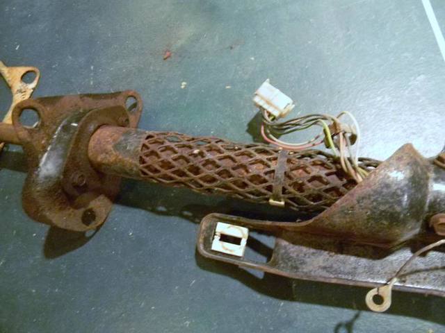

I have contemplated this very thing . . . needing additional room between the steering wheel and myself.
Has anyone ever done a "chop" on a stock crush can???   :driving:
Burdar
Just throwing this out there...
On an A-body, the steering column outer jacket isn't a solid piece.  It is a metal "mesh".   This is what collapses in an accident.  On an E-body, the outer column jacket is solid and it's the crush can that collapses.  I'm wondering how safe an A-body Tuff wheel adapter is when installed on an E-body.

wanderlustin
Quote from: Burdar on September 25, 2019, 10:26:17 AM
Excellent point.  The A and B-body cans do not collapse.

Katfish
I can't really believe what we call the "crush can" on E-bodies is meant to collapse.
The lower column pushes up for this purpose.
Your chest hits that wheel with enough force to collapse that and your toast.
Katfish
I don't doubt they claim that,
Hit that can with a hammer hard enough to collapse it, and I guarantee a blow 1/2 that hard to your chest is not something you walk away from.

wanderlustin
Quote from: Katfish on September 26, 2019, 08:22:47 AM
@Cuda Cody and I stumbled across this "crushed can" this afternoon! :unbelievable:
CudaMoparRay
Crash can better than a solid piece of metal or nothing but none-the-less I would like to see what the persons chest that hit it looks like  :rubeyes:
Original Mopar engineer crash can tester with a 426 Hellephant on him :rofl:
