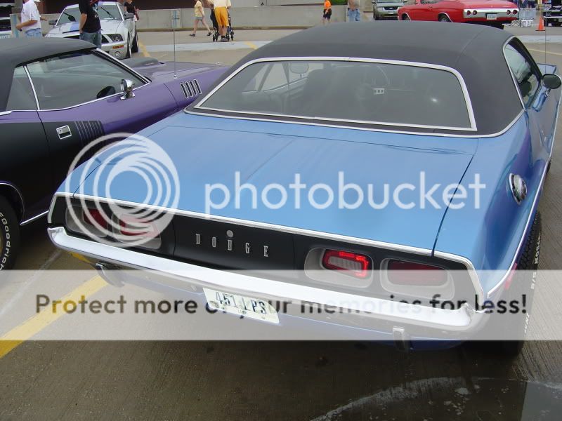

1971 Challenger R/T...black organisol

The Cuda tail panel is the one most people get wrong.  I guess it's not really wrong, but maybe a more polite way of saying it would be they do it differently then what the factory manual specs.   They often to do not paint the blackout low enough...
http://www.e-bodies.org/Resources/Engineering_Illustrations/Black_Out_Tail_Panel_Cuda.pdf
