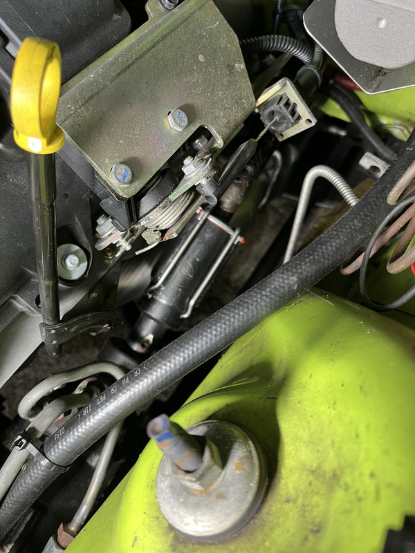

Hate to bring this up, but you helped me, so I'm returning the "favor"
I think you have the steering coupler retainer installed wrong. I ordered the longer 3.5" version you mentioned and it worked. I have a Borgeson box, so it has the longer coupler. I still fought with it for 2hrs. But finally got it on.
The retainer seats in the roll pin holes.
Instructions, on DMT site, show the way it should be.
https://www.detroitmuscletechnologies.com/mopar-a-b-e-body-66-73-dodge-plymouth-3-stainless-steering-column-coupler-cover-clamp-retainer/
