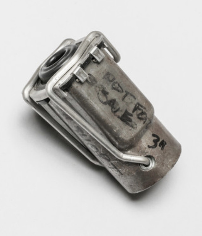

#261
Hate to bring this up, but you helped me, so I'm returning the "favor"
I think you have the steering coupler retainer installed wrong. I ordered the longer 3.5" version you mentioned and it worked. I have a Borgeson box, so it has the longer coupler. I still fought with it for 2hrs. But finally got it on.
The retainer seats in the roll pin holes.
Instructions, on DMT site, show the way it should be.
https://www.detroitmuscletechnologies.com/mopar-a-b-e-body-66-73-dodge-plymouth-3-stainless-steering-column-coupler-cover-clamp-retainer/
1970Cuda
Quote from: Katfish on December 11, 2025, 02:37:51 PMHate to bring this up, but you helped me, so I'm returning the "favor"
Hey thanks Katfish - Now that does make sense how it's installed and I appreciate your passing along your installation experience to me! I just tried it on my steering column and it worked just fine. It looks a lot better and now I see how it gets installed. I didn't realize that there were directions available for this installation from Detroit Muscle. I just guessed at it. But it's funny that the longer one fits neatly under the coupler. See updated picture.
The one thing I did find though was using the old NOS roll pins vs. the new (and harder material) roll pins. I bought a number of original roll pins for my coupler, because they are made of softer material and seem to install better and easier (IMO).
