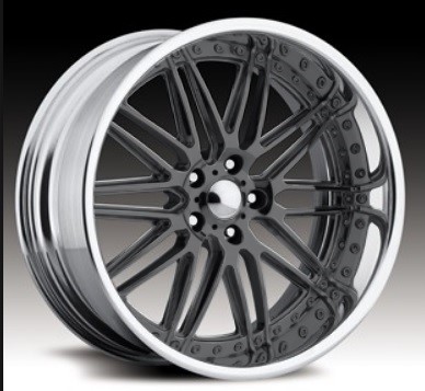

I found these wheels that I like a lot.  They are custom made so I can get them exactly how I want them.  Online pricing is probably way outdated though and I have no idea how long it would take to have them made.

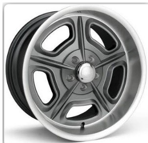

Then I found these at Summit Racing.  They are a lot less expensive and it seems like it wouldn't take long for them to be delivered if I go this route.  They only offer 18x7 and 18x10.  The 10" wide won't fit in the back.  They do offer a 20x8.5 that would fit.  They are listed as Chevy/Ford wheels though so I'd have to check the center register diameter to see if they would fit a Mopar.  Also, I don't really care for the "machined" outer lip.  I'd prefer a polished lip.

Car and paint look amazing!  :clapping: :worship:  I know I'm late to the party but regarding wheel choice I would go with the first ones personally.  Not a real fan of those kidney bean type wheels but that's just me.
