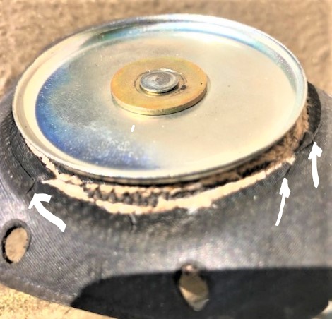

Fuel gushing up on fire up today when trying to fire up and was spurting up out of the small hole on top of the fuel pump when cranking over. ECU pick up connector was right above it.
This means the bellows inside the pump, dry rotted out and leaked through to the atmosphere dry side.
Cranking the engine made a Geyser of fuel up which shorted the ECU connector together and that was no doubt what created the engine Harness Fire.

3,000 miles away, one week ago, I sent my pump out to Then & Now Automotive in Mass.
Received it today. 7 day turn around at a very affordable price.    :unbelievable:
The pump diaphragm rubber parts they have is Ethanol Resistant.  :yes:
And to get it all done....Replace your accelerator pump boots with the Blue Ethanol resistant foamy's.
Then replace all lower fuel lines with Ethanol resistant rubber. I just bought 5 feet of it online.
