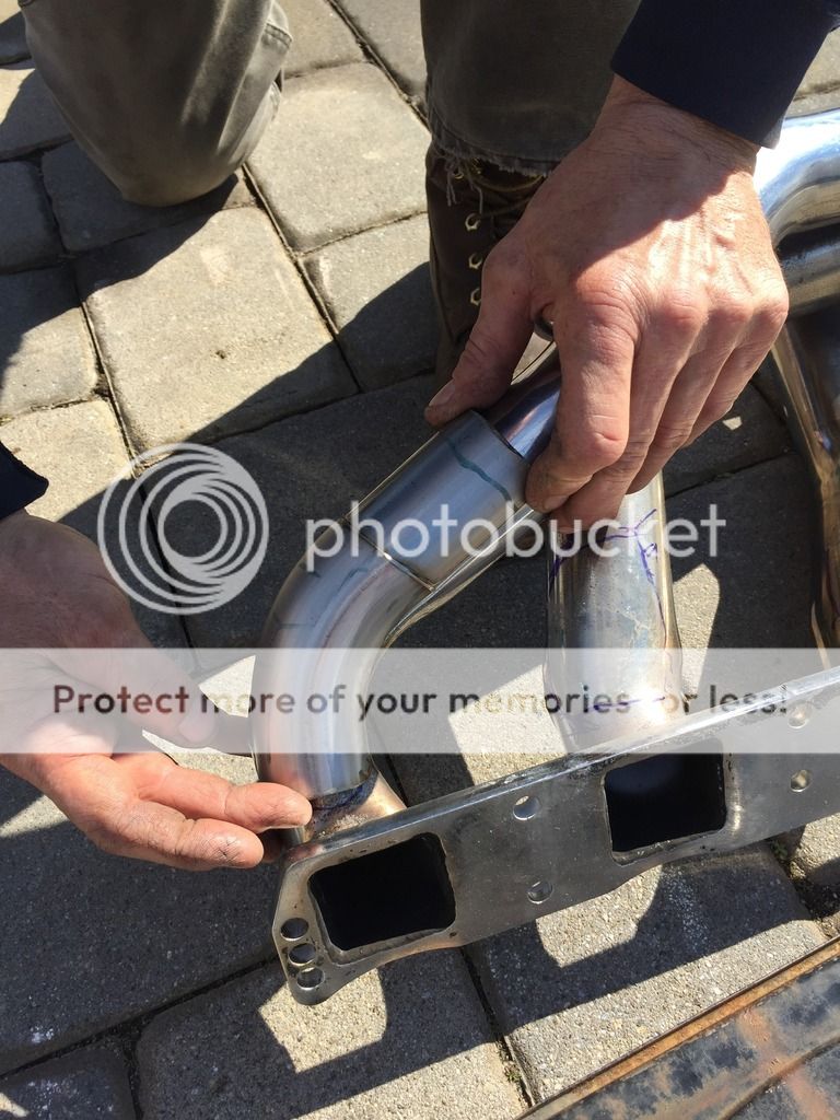

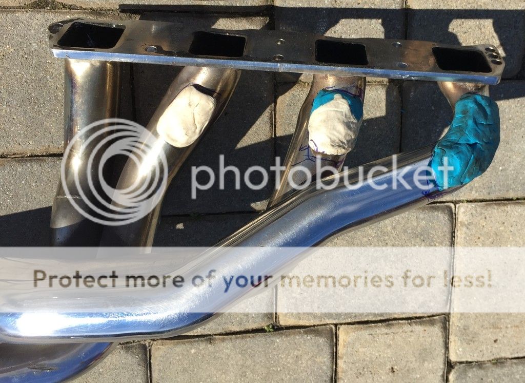

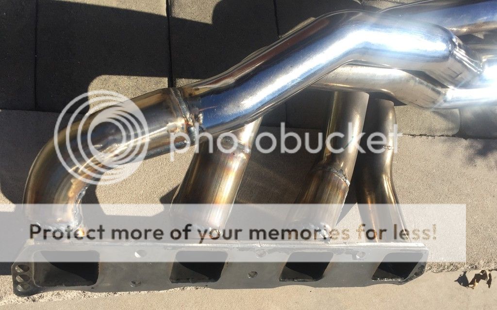

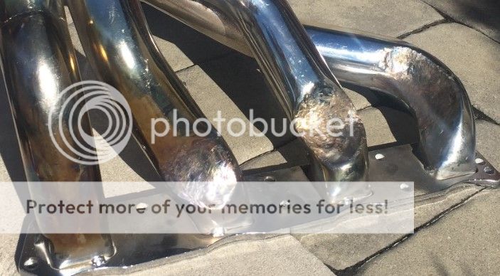

I decided to replace my manual box for power steering. (Easier said than done). I didn't want to give up my headers for stock manifolds so I had to do a little metal work to make the new box fit.
Now that I crushed the tubes I felt like crap knowing I took a vintage set of headers and beat the tubes in. By the time I was done making them fit I couldn't believe how much I restricted the flow. Now what do I do? I decided to take some PlayDoh and formed it in the dents to replicate the original round tube. Then I took the PD and formed it to the back of each tube. This way I transferred the volumn I lost in the front of the tube and gain it back when I'm done making the blow out patches.
Now I have to make a patch for each tube.
I cut out each tube to fit the patch and with a little welding...
I don't feel so bad now!
