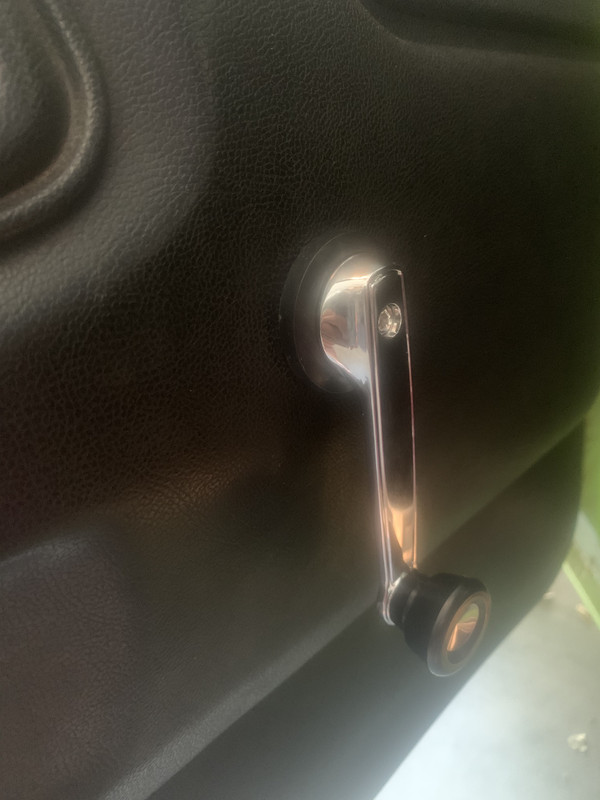

Should the front panel have the spring?
I bought new window cranks and spacers.
The repos are 1/2 as thick as what I have now.
They leave a big gap and are sloppy
Here's a pic with the thick spacer, it seems right.
If not, curious what application they are for.
No springs on the front, thick spacers are correct, thin ones are A & B Body I believe  :alan2cents:
