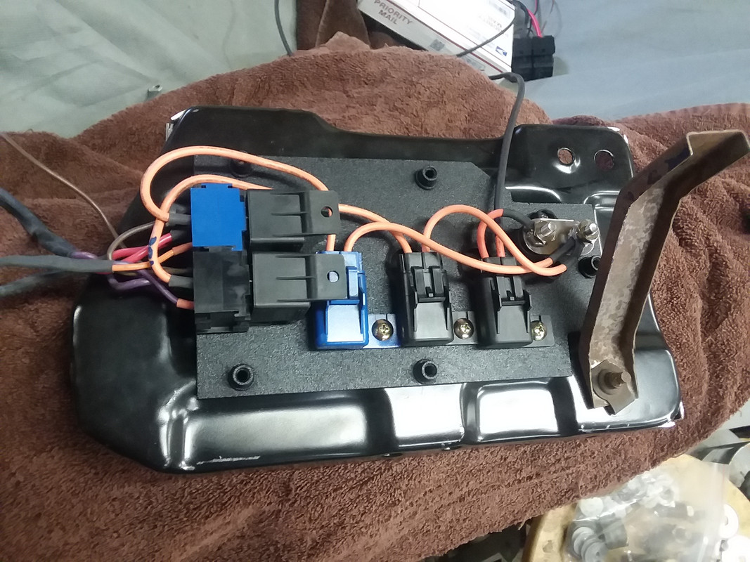

I'm using this exact one in the resto-mod I'm building, feels like pretty solid construction, I'm happy with it. :twothumbsup:
You can see it in the upper left hand corner of this picture...I'm using it to connect the main power cable coming from the trunk to the power cable going the the engine harness.
