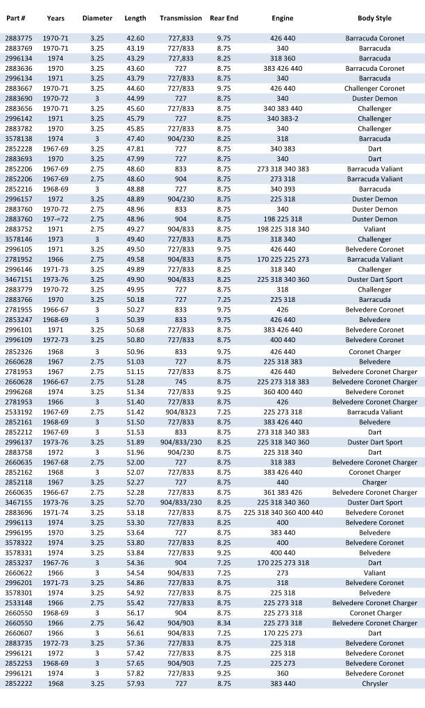

nO 727 & 833 are the same length

To answer Cuda Cody, i was told the gears are 3.23 though i have not confirmed it.  my car drives except that currently i dropped the reared to have it rebuilt, which is what lead me to start inquiring about the transmission because i figured i would need to possibly change the gears in anticipation of a manual transmission.
