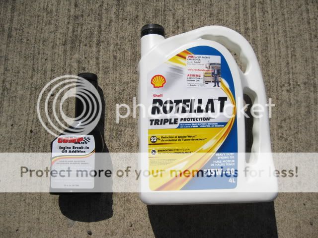

This was recommended by my engine rebuilder: Shell Rotella T 15W40 and 1/2 bottle(6 onz) Comp Cams Break In Additive.

Quote from: Jay Bee on April 12, 2017, 03:02:41 PM
I think for your first oil change for a new motor, that is a great combination  . . . But after breakin . . . I just want something effective and priced decent.   Many different choices out there . .
