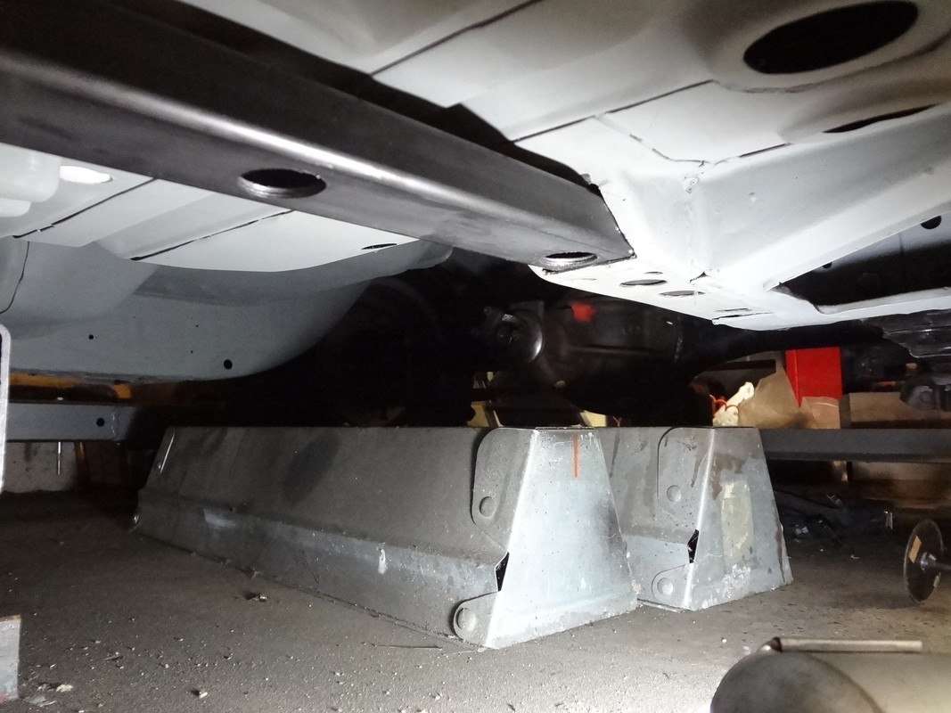

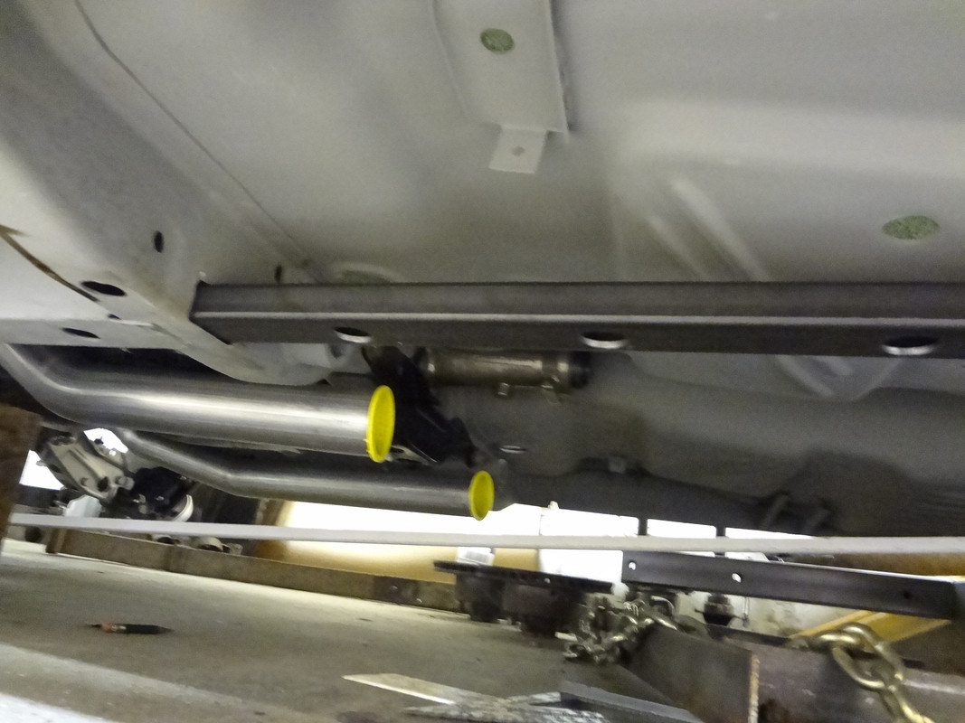

I used the advice of @Brads70 and @303 Mopar when doing mine.  I used 1 x 2 tubing and drilled holes for the round tubing like Brad.  I also cut holes in the torsion bar x-member and rear frame rail to run the connectors inside like 303 Mopar did.  I needed some extra clearance around the floor pan so I used  a band saw to cut a slit almost all the way through the tubing.  That slit was just enough to bend the tube for clearance.  The slit can then be ground smooth.
Odin
Thank you to all who provided advice and photos. Mine are not pretty but they are in!

Here are mine, so far. (US Car Tools)
I like those better than the ones I had installed for sake of rigidity
