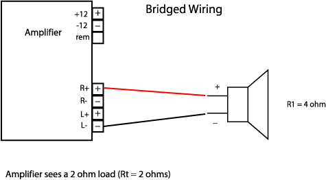

Can the original mono speaker still be used with a new stereo (think of a y-splitter). Or would this blow the speaker?

Quote from: kawahonda on September 05, 2018, 09:24:00 AM
Front: mono
Rear: stereo
You can wire a single speaker to a stereo by using the + from one channel & - from the other ...  Stock speaker will not be up to handling the power from modern head units.
There are 4x10" speakers that will or you could, as I have, fab a plate to mount 2-small speakers. I used tweeters as the small speakers won't have much grunt anyway.
