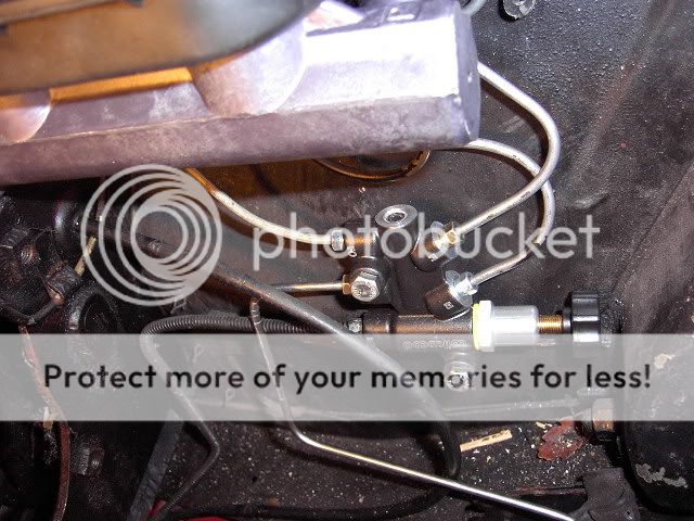

Id be tempted to lose the stock prop valve. This is what I am going to use. This splits  the front and serves as the distribution block as well.
How much dive are you getting on the front? It may need dampening adjusted as well, you may be transferring too much weight to the front and unloading the rear tires too much. No matter what you do, the rears will lock in that condition very easily.
The whole car may need some dialing in for the system to work, I'm not sure what all you have tried, but I wouldn't condemn the brakes just yet. The car likely has ~55-60% of the weight on the front statically, even worse under typical braking conditions. You need to try to keep some weight on those rear tires during braking if you want the tire to grip and help slow the car.
That looks like a nice set up, but I do not think I have enough room between the M/C and inner fender so it would have to mount lower where the stock distribution block is now.  I'm not getting much of a front dive at all and the rears are doing the majority of the work.  I talked to another e-body buddy here with the Wilwood set up and he said he just removed the proportion valve spring out of the stock distribution block and it made a world of difference.  That may be the first step.  Another round of bleeding brakes... :Thud:

Quote from: 303 Mopar on May 27, 2017, 08:26:52 AM
Quote from: GoodysGotaCuda on May 27, 2017, 07:04:43 AM
I haven't mounted it but a quick hold against the firewall, it looks like I have plenty of clearance.

:iagree:  On the Wilwood M/C the front res is for the front brakes.  BTW, I ordered the Wilwood distro/proportion valve (wilwood 260-11179) and will install in a week or two.  And will bleed the brakes again   :Thud:
GoodysGotaCuda
This setup is close to the inner fender, may require two 90° fittings for the front lines, but that's not too bad.
