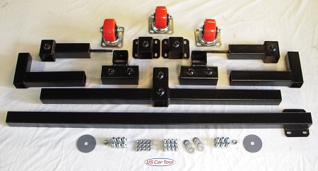

Ordered a US Car Tool K-Member Stand/Cart so we can put the engine and trans on the cart together and roll it under and lower the body onto the K-Member. They were sold out and were waiting for some to come back from powder coating.
Ours will be QA1 K, 6.1 and 727

Got my US Car Tool K-Member Stand/Cart put together today.
I had to modify it a little to fit my QA1 K-Member.
I utilized the Sway Bar Mounting holes on the K and a couple extra parts to mount the K on the stand by the sway bar mounts.
It centers the K better. Had to ream out the holes in the K for the Hotchkis Strut bar bushings to fit.
Killed 2 Harbor Freight Step Bits in the process.
I test fit the UCA and strut bars. Probably take them off before trying to set the engine on it.
Now to get the engine on it. Bought a HF Engine Hoist so I can pick up the engine and set it on the K.
My helper is gone for winter break so it's just me. Mostly just me even when he's here...  but I don't mind.
It's good ME time.  :yes:
The Control Arms are powder coated. The ball joints I painted with Cast Blast.
