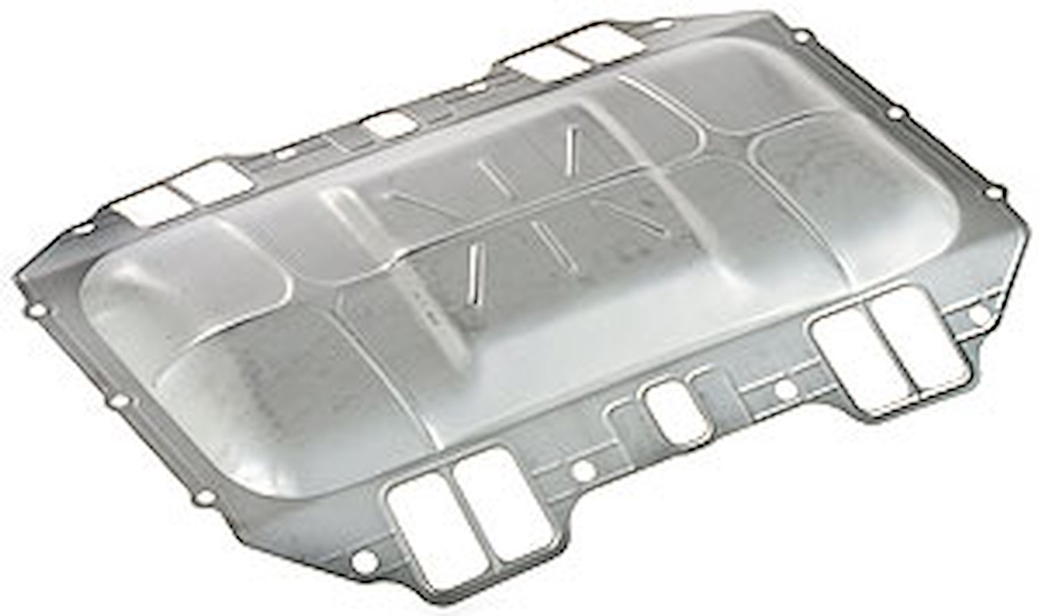

I screwed up the intake gasket install this weekend. Put on the gaskets with the belly pan in between the four of them, put rtv on the block, bolted the pan in place, put rtv on the top of the gasket, and when I went to set the intake on the car I noticed that the new belly pan gasket was different from the old one.
See how there's a hole in the middle on each side? WEEELLLL, the one I just bolted to the car didn't have it.
Cleaned off the (dried) rtv as best I could, used the old belly pan gasket, slapped some more rtv on there and bolted it up. Needless to say the car won't run right anymore, so I'm going to take it apart again when I get the new gasket in. Seems to have developed a miss and the exhaust just sounds wrong. Time consuming lesson learned in checking parts before bolting them on.
Since I have to replace the gasket again, I'm considering buying one of these...https://www.summitracing.com/parts/edl-7193/overview/make/dodge

You can usually re-use those gaskets, maybe it's been done before. Had you considered drilling the new one? It sounds like the heat crossover passage was missing, that is a common mod for warm climate cars but the automatic choke won't work correctly.

That's exactly what it was. Heat crossover passage was missing. I've read that it almost needs to be blocked off for an aluminum intake and it essentially makes it a warm weather motor. Didn't know it affected the auto choke.

The choke well coil is heated by the air in that passage, when it gets warm the coil expands and pulls the choke off. I would just drill the hole in the new gasket but it sounds like you have one coming anyway. Did the old gasket you took off use the paper gaskets? I wouldn't bother with them if it didn't use them before.

That is exactly why I gave you that part # it blocks the heat crossover & the engine will run better except got eh first 2 minutes while it warms up , you can use an electric choke if you feel you need a choke .
I basically always block the crossover , it is hard enough to get these car to start with todays junk fuel  when they are warm anyway without overheating the carb with exhaust heat running below them .
